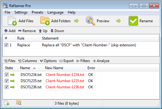

For example, you could use a single Replace rule to replace "DSCF" with a client number:

#8 2018-02-26 16:21
Re: DCSF to Client number
Hi ejasuoe, thanks for the explanation.
To replace 'DSCF' by '7899'
utilize the Replace rule
Find: DSCF
Replace: 7899
If you need support on adding the files see this:
ReNamer:Adding_files_and_folders
