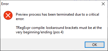

Unfortunately I am getting an error in Renamer.
TRegExpr compile: lookaround brackets must be at the very beginning/ending (pos 4)

Regarding the error message:
This is a known limitation of the regex engine, as documented here:
https://regex.sorokin.engineer/en/lates … assertions
Brackets for lookahead must be at the very ending of expression, and brackets for lookbehind must be at the very beginning. So assertions between choices |, or inside groups, are not supported.
It should be possible to achieve the same result with multiple rules or pascal script.

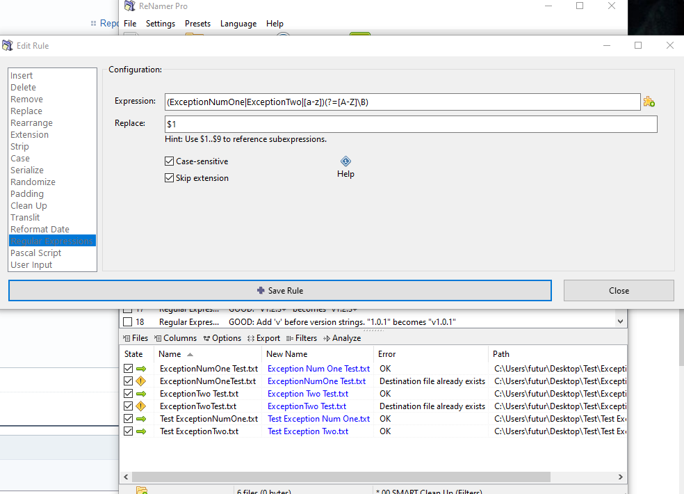

While it works if an exception occurs at the beginning of the filename with no spaces, it falls apart if the exception occurs anywhere else in the string. See this image:

Thanks much for the help. Unfortunately the expression you supplied isn't working:
I need the exceptions to remain as they are no matter if they are part of a word, or isolated by whitespace. Right now if the exception occurs alone followed by a space, the word is separated (Check image above).
Also I plan on having a large amount of exceptions (100+) so some kind of PascalScript implementation I think would be better so I can store my exceptions in a constant.
Ah you are right - if the exception matches but isn't followed by an upper case letter the regexp engine throws away the match and tries to find another match ...
Using the first part as atomic match would help here. As there won't be a second try you have to make sure that your exceptions are placed in the right order if one exception is the beginning of another longer one:
(?>ExceptionOnePlusMore|ExceptionOne|[a-z])(?=[A-Z]\B)
