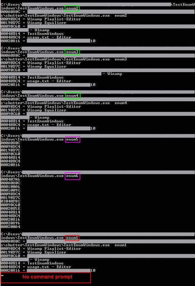

Great news (problem identified and you can fix it with changing the window enumeration method):
Today it happens and I got a problem signature. It is the reader_sl.exe process (Adobe Acrobat SpeedLauncher, which can't be disabled anymore with version 17.8.30051/2017). The reader_sl process doesn't start with windows anymore. It seems to be, that it starts now only before Adobe Acrobat Reader will search for updates.
Then I have used your command line enum tool:
enum1: shows all windows but didn't finished (no command prompt after all windows are listed!).
enum2-4: list the same windows and then the command prompt.
enum 5: list the same windows, but without its title names (only the numbers).
enum 6: list more windows, but also without any window titles.
I have tested it also with my autoit script and this has worked at the same time (while reader_sl.exe process was running and Shutter was freezed). It seems to be, that autoit uses one of the enums 2-4.
Edit: If I kill the reader_sl.exe process while shutter is running and freezed by the dropdown menu of the "close window" action, it works immediately and shows all open windows.
