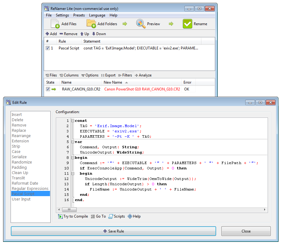

I tried it, but with your code nothing happens to the name. If I run the command "exiv2 -Pt -K Exif.Image.Model test.CR" the output was generated. Only if I use it in a "pascal script" it won't work.

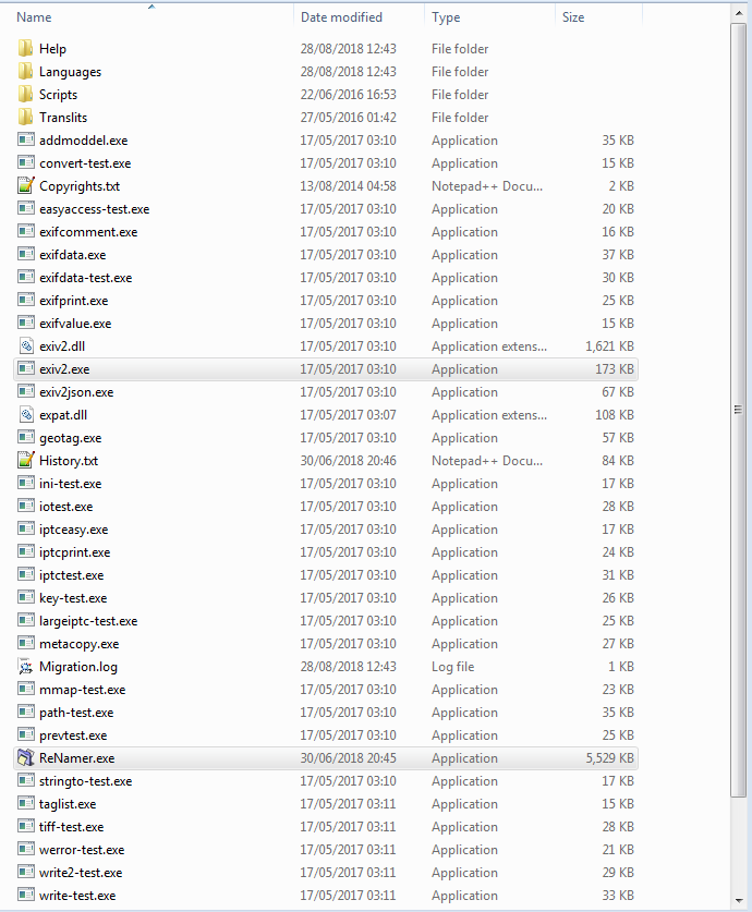

I have just tried again and it works fine with ReNamer 6.9, exiv2 0.26, script as in the previous post, and a sample CR2 image shot with Canon PowerShot G10. Sample image downloaded from http://www.rawsamples.ch/index.php/en/canon.
You should try again with an isolated portable version of ReNamer and a single renaming rule. There appears to be something that you are missing or doing differently, but it is not clear from your description. See screenshots below.

You could rearrange it after the fact, using Rearrange or Regular Expression rule. But it may be better to just adjust the script to insert the camera model tag in a different way.
Find the last line in the script:
FileName := UnicodeOutput + ' ' + FileName;
And change it to:
FileName := WideExtractBaseName(FileName) + UnicodeOutput + WideExtractFileExt(FileName);
This will insert the tag as suffix (before file extension) instead of as prefix.

Change this line:
To:
FileName := WideExtractBaseName(FileName) + '[' + UnicodeOutput + ']' + WideExtractFileExt(FileName);
The trailing dash can be added in the script (similar to the above), or as a separate Insert rule for a better readability.
