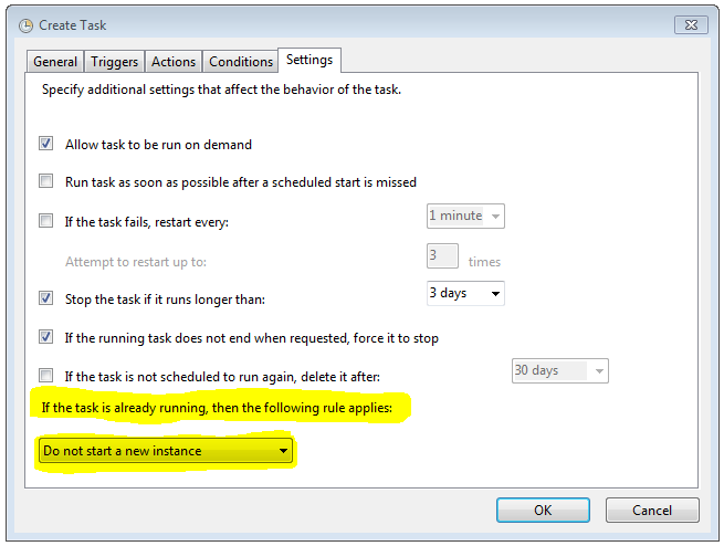

Create Task > Settings tab > If the task is already running ... Do not start a new instance.
This might mean that you will always have to use the configured task to start your program, otherwise it may not be able to detect an already running instance. Try both ways to know for sure.

Ah yes, that option is set by default:
Yes, it appears it works like that, a new instance always is opened. So I would have to open the same program always with that task, not that convenient, I guess.

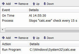

Shutter can also start an application only if it is not running.
The example starts the windows calculator at 14:55:30 only if it is not running (logic have to set as "all"):

What does the line mean next to "Process": "Stops "calc.exe"..."?

"calc.exe" is the process name of the calculator application and it's only an example for the process name of your application. Replace it with the process name of your application which you want to run only if it is not running. "Stops" means that the action is executed if the process (in this example "calc.exe" for the calculator application) of the application which you want to run isn't running.
You can test the example with absolutely no risk on your machine. Set the time you want and then it will only start the windows calculator if it is not running at this time (+ up to 15 seconds for the check interval with this example).
