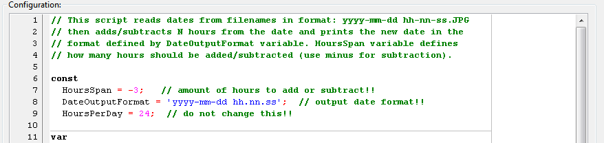

* Advanced Pascal Script editor with syntax highlighting, code folding, etc;

Congratulations Denis, can't wait to check it out! Am excited about this new version, especially when I see things like the following in the change log:
Sounds nifty, downloading right now! smile
Edit: Whoa, EXE size has doubled! Also, any way to turn off that 80-character vertical line?

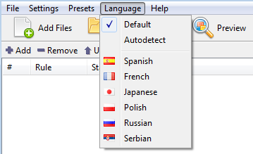

ReNamer 6.0.0.2 Alpha released, with languages menu and main menu accelerators.
Languages menu contains individual languages (all found *.po files) with their corresponding country flags, and also two special options:
  • Default - original interface language.
  • Autodetect - detects user language via Locale ID, "--lang" parameter and "LANG" environmental variable.

Andrew, the 80-character gutter line can be disabled, but I think it is actually useful.
It promotes a more readable code without actually enforcing any limitations.
Meh, I don't think it's all that useful. If turning it off can be made a setting that would be nice but it's not a priority. Would also be nice to have a word wrap feature.
Coming to languages, how is the language code in the .PO file i.e. "Language: es\n" or "Language: fr\n" translated into the string "Spanish" or "French"? Is that hard-coded in the program? If so that means to get a new .PO to be listed in the menu you'll have to modify and recompile the program, right? Isn't it possible to have the language name also mentioned in the .PO file itself, like so:
"Language: es\n"
"DisplayLanguage: Spanish\n"
"Language: fr\n"
"DisplayLanguage: French\n"
That way simply adding a .PO to the Languages directory would make it show up correctly in the menu without needing to modify the program (the keyboard accelerators would need to be assigned dynamically of course). Is this possible?
Also, can the current system correctly handle multiple languages per country (so the flags for all of them will be the same)?

From v6.0.0.4, language details and list of translators are stored in PO file headers, similar to what you have suggested. smile
Cool, and works really well too! cool
Few more things:
1) The current language is shown with a check mark that replaces the flag. Instead of a check mark what do you think about retaining the flag and highlighting the current language in bold?
2) Currently I don't think X-Country-Name is used anywhere, right? How about displaying it in two places:
i) In the dialog shown when you select a language (as a line between X-Language-Name and X-Translators).
ii) In the menu as Language Name (Country Name)? This way instead of two instances of English with just a small US or UK flag to distinguish, we'd have English (US) and English (UK). Similarly Portuguese (Portugal) and Portuguese (Brazil) instead of simply two instances of Portuguese.
I don't like the idea of changing the style of menu items to highlighting the selected item. It goes against some user interface practices.
I liked that idea initially and tried it, but it didn't look great on practice. All languages appear with redundant description, e.g. Russian (Russia), Spanish (Spain), French (France), etc. Instead, I decided to display native language name in the brackets, e.g. Russian (Русский), Japanese (日本語), etc.
For language name clashes, we can set the "X-Language-Name" header to "Language Name (Country Name)". In the meantime, "X-Country-Name" header is not used directly, but may be in future.
More detailed instructions: http://www.den4b.com/wiki/Localization
