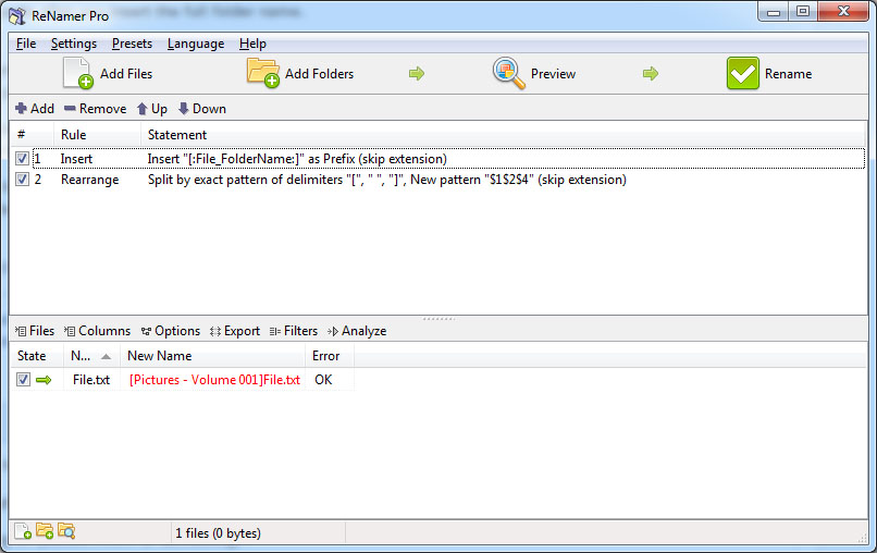

It is awesome that there is such a function but...
Hmmm what am I doing wrong?
this is the path: C:\Temp\Pictures - Volume 001\File.txt
#4 2015-01-26 22:56
Posts: 3,497
Re: Use only the first word of a folder
There might be a non-standard space character involved (one of unicode variants).
Can you try using RegEx rule instead:
1) Insert: Insert "[:File_FolderName:] " as Prefix
2) RegEx: Replace expression "\[(.*?)\s(.*?)\]" with "$1"
If it still doesn't work, please use "Export all columns to clipboard" option from the "Export" menu and paste the content here as code (use the button in the toolbar when writing a post).
