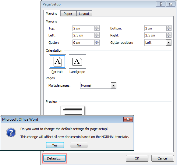

I liked how the same concept was implemented in MS Word, where Page Setup options are session-wide, while a "Default..." button saves them as default settings for future sessions. I think this could be implemented is a similar fashion in ReNamer.
