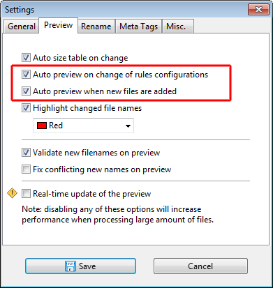

A forced preview before rename is redundant in my opinion. It can also bring more harm than benefit.
For example, preview will discard all manual changes, unnecessarily reapply a PascalScript rule which modifies files, etc.
For the reference, there are two options for auto preview, which are enabled by default:
  • Auto preview on change of rules configuration
  • Auto preview when new files are added

Oh, I see: ... "Auto preview", not "Real-time update of the preview", sorry.
But then, ....
what is the difference between the asked "forced preview" and the existent "Auto preview" option?

"Real-time update of the preview" option does something very different. It may be useful when working with very large file sets or doing some computationally heavy tasks in PascalScript.
Real-time update of the preview can be dangerous and its use is not recommended!
It will cause graphical updates to the GUI during preview for every processed file but will also respond to any user activity such as mouse clicks and keyboard button presses. Beware, any accidental actions generated during a preview as a result of user activity within the application will interfere with the preview process and can cause unpredictable behavior.
