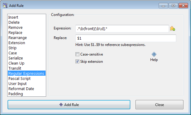

#6 2016-10-06 22:14
Re: remove all except one word
You are not entering the rule configuration correctly.
Here is a demonstration of how it should be entered:
#7 2016-10-06 23:36
Lauraq
Registered: 2016-10-02
Posts: 110
perfect, thanks smile
