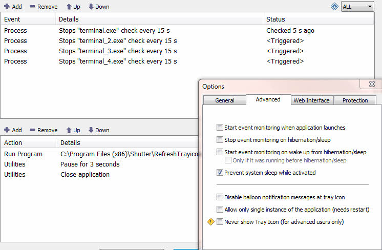

Shutter is only used to prevent Windows from going into sleep/hibernate mode automatically. It is started automatically with the same preset (via command line) by up to 4 applications. The applications are started also automatically by the Windows task scheduler. To save RAM and Windows tray space I don't want to have 4 instances of Shutter for the same events and action.
Otherwise it should be possible to start a second instance from another application with a different event and action. I hope you can understand what I mean.
I use an autoit script (as standalone executable) to close specific Shutter instances when one of the 4 applications starts. This executable is started automatically with the applications.

Windows task scheduler starts the autoit script (see post #3) for terminal.exe at windows logon or time based at the same time as the other terminals.
Windows task scheduler starts the autoit script (see post #3) for terminal_1.exe at windows logon or time based at the same time as the other terminals.
Windows task scheduler starts the autoit script (see post #3) for terminal_2.exe at windows logon or time based at the same time as the other terminals.
Windows task scheduler starts the autoit script (see post #3) for terminal_3.exe at windows logon or time based at the same time as the other terminals.
Note: each of the 4 scripts uses a different sleep parameter (+2000 ms) and not all 4 scheduled tasks are always activated. There are also links to these 4 scripts on the desktop and in the start menu, if I want to start any of these terminals manually.
Shutter_3.exe should always running only one instance at the same time, because preset #1 is used for all 4 terminals.

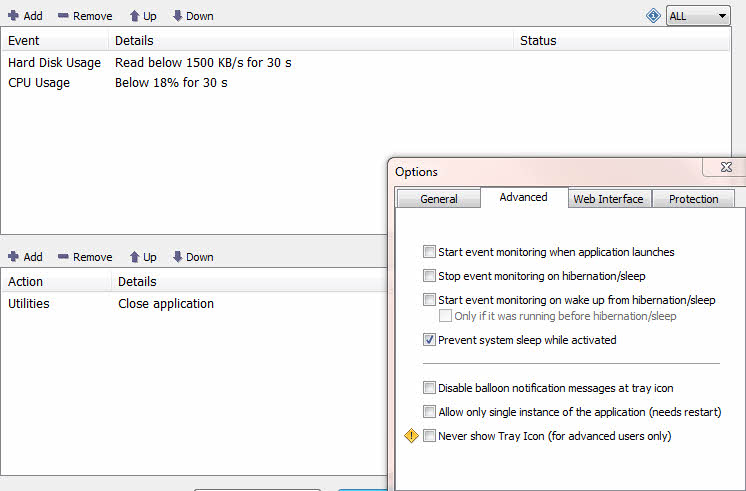

Shutter_4.exe, only running preset #3 and only started via command line with the antivirus scan

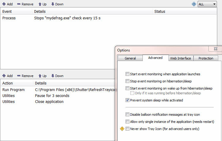

Shutter_2.exe, only running preset #2 and only started via command line with the defrag application
