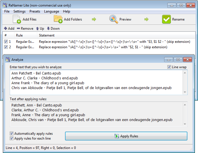

It is not possible rearrange both the 2 words and the 3 words authors in a single execution, using the Rearrange rule. However, you could do that with two separate executions, or use a Regular Expressions rule instead.
To rearrange 3 words authors:
Rearrange: Split by exact pattern of delimiters " ", " ", " - ", New pattern "$3, $1 $2 - $4" (skip extension)
To rearrange 2 words authors:
Rearrange: Split by exact pattern of delimiters " ", " - ", New pattern "$2, $1 - $3" (skip extension)
You could add all files, use the 3 words rule first, unmark unchanged files, rename (only marked files), clear marked files, mark the remaining files and apply the 2 words rule to the remaining files.
Note: This method is prone to errors, especially if the filename contains multiple " - " delimiters.
It is better to use the following Regular Expressions rules:
1) Regular Expressions: Replace expression "\A([^-\s]+)\s+([^-\s]+)\s+([^-\s]+)\s+\-\s+" with "$3, $1 $2 - " (skip extension)
2) Regular Expressions: Replace expression "\A([^-\s]+)\s+([^-\s]+)\s+\-\s+" with "$2, $1 - " (skip extension)
These two rules above will handle both 2 words and 3 words authors in a single execution, and won't mess up files which don't follow the required pattern, e.g. 4 words authors.
