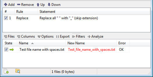

Yes, in 'ADD Rule' then 'Replace' I replaced the dash with an underscore. But in all the options I don't see anything that allows a 'space' to be replaced by an underscore or dash. Maybe 'space' is designated differently on the options?
#4 2018-12-14 10:42
Posts: 3,501
Re: Replacing spaces with underscore
The space character is not treated differently. Just type out the space in the Find field and the underscore in the Replace field.

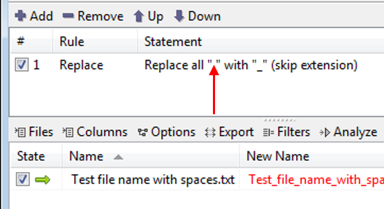

What do you mean by, "type out the space"?
In other words, what did you do in the replace panel to get what the red arrow is pointing at in the image? I tried typing single quote marks with a space between them, double quote marks, even just moving one space on the bar, but none of these made underscores where there are spaces in the file name.

Just press the space bar on your keyboard, while the cursor is in the Find field of the Replace rule. No quotes.
Also, add a Clean Up rule before the Replace rule, with the "Normalize Unicode spaces" option enabled, to fix unusual white space characters. See the previous post for more information.

Yes, that worked.
What I had done previously was thinking that the since 'Normalize unicode....' was already checked by default I thought it was already added and so closed the panel instead of closing with the left, 'add rule' button. Now I know that any rules must be 'added' whichever configuration. smile
