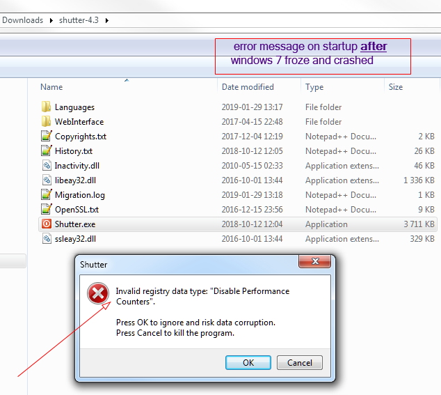

start shutter -> message box -> cant add event (access violation) & Invalid Registry Data type

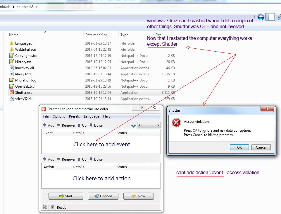

After PC Crash -> Startup shutter -> message box ->
* Invalid Registry Data type:  "disable performance counters"
* cant add event (access violation)
Long:
Has used shutter for several month with very excellent results to turn off the monitors on time.
Today, windows 7 froze and crashed when I did a couple of other things related to hard drive check a faulty wd-disc. (wd-Data Lifeguard Diagnostics windows)
Shutter was OFF and Not involved in the crash^
Now that I restarted the computer everything works except Shutter..
which shows error message on startup and error reporting box (access violation) when I am adding an event. See pictures below.

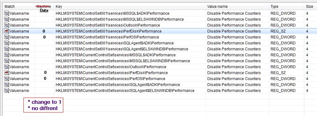

Registry key "disable performance counters" manually changed from 0 to 1
no difference, same message error when starting shutter,  help;)

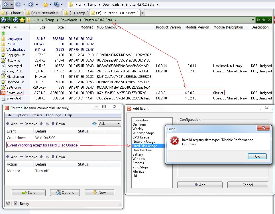

Great and thanks for this new beta build v. 4302
Seems like this new release are working just fine.. exept for..
* Hardisk Usage
  This event still give me; Invalid Registry Data type:  "disable performance counters"
  Its fine, im not using that Event:)

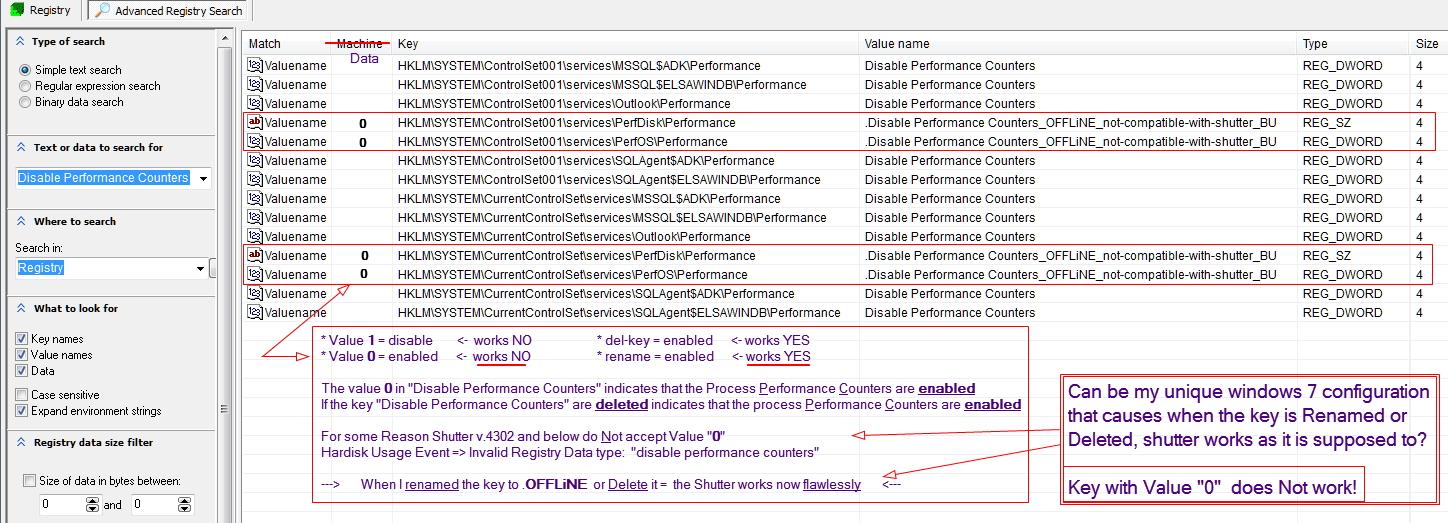

I Renamed the registry key "Disable Performance Counters"
* Value 1 = disable
* Value 0 = enabled    <- works No
* del-key = enabled    <- works Yes
* ren-key = enabled    <- works Yes
* How I Reproduce the Error in my Win7 / Raid-10 Environment .
  Add key "Disable Performance Counters" with value "0" to registry PerfDisk\PerfOS
  Shutter v4.302
  Invalid Registry Data type:  "disable performance counters" (only with: Hard Disk Usage event)
  Shutter v4.30 & below
  Invalid Registry Data type:  "disable performance counters"  +  cant add event (access violation)
   Quick Fix ;)
* Rename the key to ".disable performance counters_offline" with value "0"
  Shutter v4.302 and below works excellent with Hard Disk Usage event
@ den4b
Hey, Does shutter contain a bug?
because, the value "0" and key "disable performance counters"
doesent seems to work along with shutter -> Hard Disk Usage event? altleast not for my unique win7 computer:)
key-offline
key inside

lodctr /R:  Before I recreated\rebuild the Performance Counter with command "lodctr"
I mounted a old complete OS-mirror-image *.spi (shadow protect)
I fired up the remote virtual registry and searched for The key "Disable Performance Counters"
This was -Not- included in my OS-Backup registry folder PerfDisk & PerfOS
Well, almost too easy to be true:)
lets give it a shot..
I Renamed 4 keys to "OFFLiNE" and .DOT as the .first .character  (see picture above^)
Now Shutter works perfectly  <--  Thumbs UP;)

There is a subtle inconsistency in your registry entries.
The data type of the "Disable Performance Counters" value is expected to be REG_DWORD (integer), but it your case it is REG_SZ (text) for the "PerfDisk" key. That is in accordance with the Microsoft's documentation on Disable Performance Counters. You can also see from your screenshots that the rest of "Disable Performance Counters" values are of type REG_DWORD, except for the "PerfDisk" key.
Shutter attempts to read the value as an integer, but the returned data type does not match the expected type, so it raises an exception.
If this value was created by a 3rd party application, then I guess it is at fault for inappropriate use of the registry. This raises a question - does "Disable Performance Counters" value with REG_SZ data type has any effect for the operating system, or perhaps it is ignored due to incorrect data type?
It is not clear how Shutter should handle such case. It currently raises an exception due to incorrect data type, but it could silently ignore the value instead.
