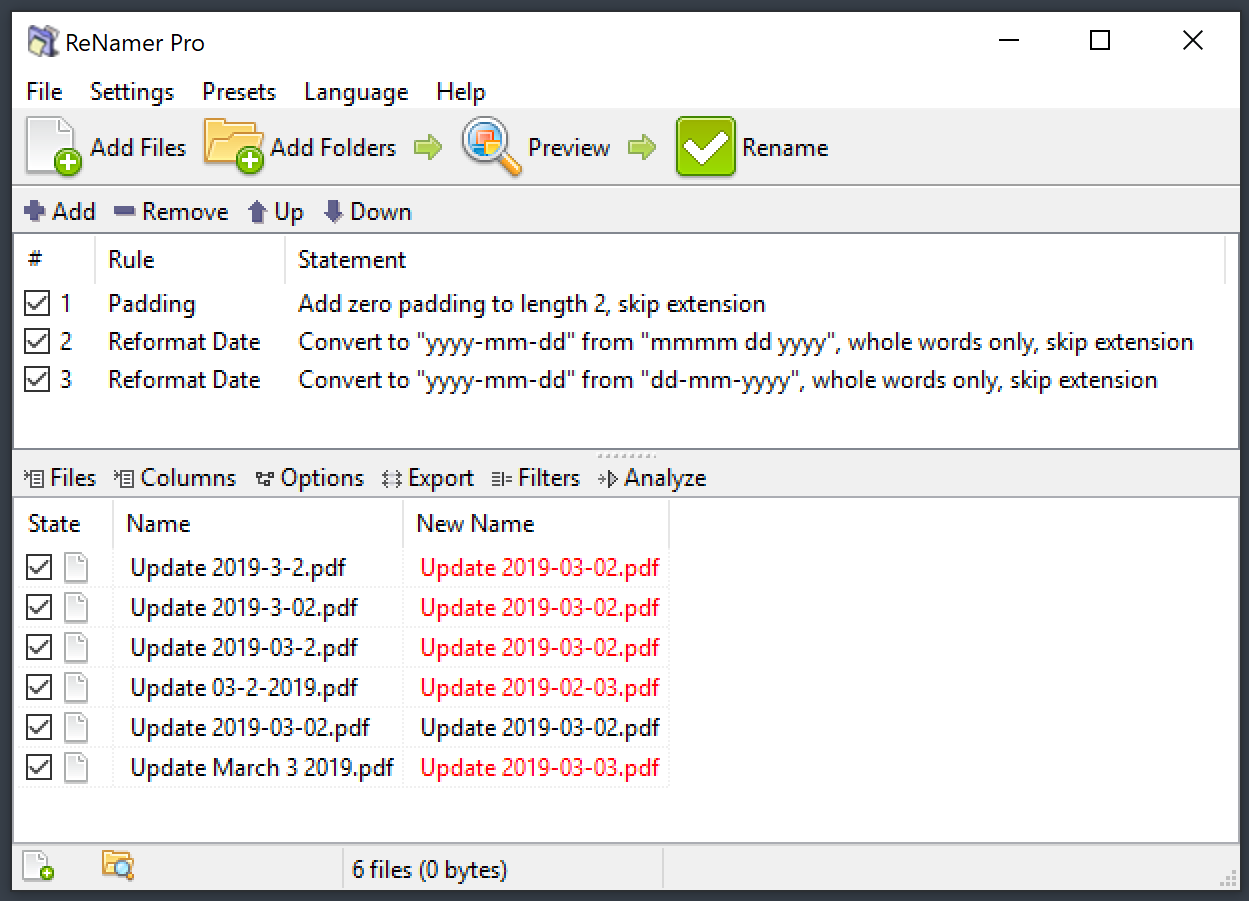

#5 2019-03-06 23:26
Re: Can we use WILDCARDS or VARIABLES in the replace field?
Why make it complicated? smile
Why not use the built in capability designed for such tasks, i.e. Padding and Reformat Date rules?
Rules:
1) Padding: Add zero padding to length 2, skip extension
2) Reformat Date: Convert to "yyyy-mm-dd" from "mmmm dd yyyy", whole words only, skip extension
3) Reformat Date: Convert to "yyyy-mm-dd" from "dd-mm-yyyy", whole words only, skip extension
Input and output:
Update 2019-3-2.pdf	-> Update 2019-03-02.pdf
Update 2019-3-02.pdf	-> Update 2019-03-02.pdf
Update 2019-03-2.pdf	-> Update 2019-03-02.pdf
Update 03-2-2019.pdf	-> Update 2019-02-03.pdf
Update 2019-03-02.pdf	-> Update 2019-03-02.pdf
Update March 3 2019.pdf	-> Update 2019-03-03.pdf
Here is a demo:
#6 2019-03-07 09:06
cool Always that new stuff. We did not have that kind of stuff before... big_smile
Thank you for reminding us on this!
>> "1) Padding: Add zero padding to length 2, skip extension"
Will also modify other parts of the name string, like my "Updat1" to Updat01
but working fine on the provide examples.
But several "Reformat Date"-rules instead working great, even with other digits in name:
1) Reformat Date: Convert to "yyyy-mm-dd" from "yyyy-m-d", whole words only, skip extension
2) Reformat Date: Convert to "yyyy-mm-dd" from "yyyy-mm-d", whole words only, skip extension
3) Reformat Date: Convert to "yyyy-mm-dd" from "yyyy-m-dd", whole words only, skip extension
Great tool, that ReNamer.
