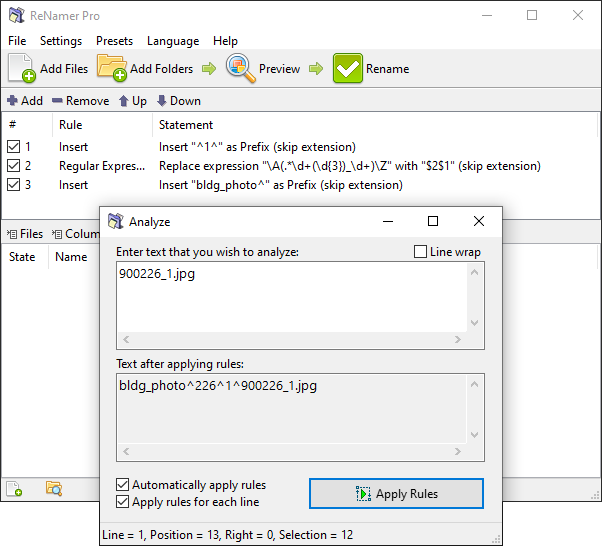

You need to use the Regular Expressions rule to extract those 3 digits.
Like follows:
1) Insert: Insert "^1^" as Prefix (skip extension)
2) Regular Expressions: Replace expression "\A(.*\d+(\d{3})_\d+)\Z" with "$2$1" (skip extension)
3) Insert: Insert "bldg_photo^" as Prefix (skip extension)
User manual for the Regular Expressions rule:
https://www.den4b.com/wiki/ReNamer:Regular_Expressions
Here is a demo of these rules in action:

Awesome -  that works!!!
thanks for the very quick response
