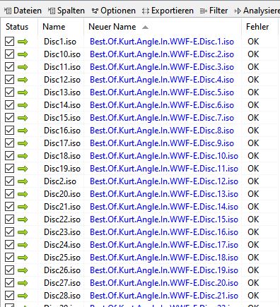

Serialize/Count files in "wrong" order?
It's me again, sorry. Can someone help me with this "problem"? The counting of the files seems odd... The software first takes 1 then 11 and so on. See screenshot. Thanks in advance. This is a really important issue for me.

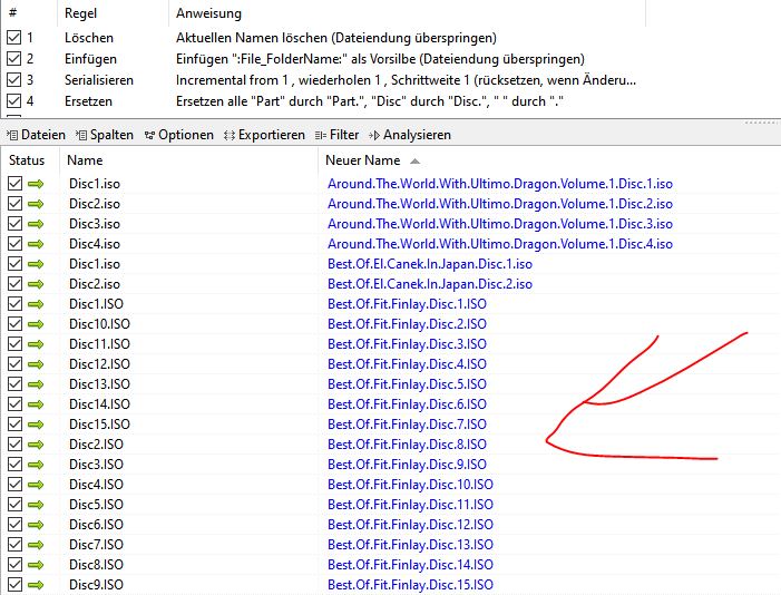

All of a sudden my solution doesn't work anymore. Seems it wasn't the solution. See screenshot. It sorts the name alphabetically like 1 10 11 .. 2 21 22... Any idea?
Strange that I thought Serialize -> tick/check "Pad with zeros to length" solved the problem. I think because I dragged and dropped the files manually from the folder. I'm pretty sure it did somehow with the first case/screenshot above... Can anyone help? Thanks again. Why doesn't Stefan's solution work? It must be the correct solution I guess. Thanks in advance!

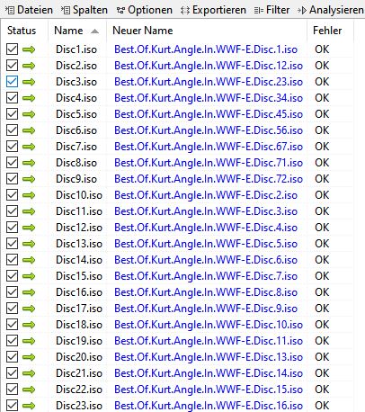

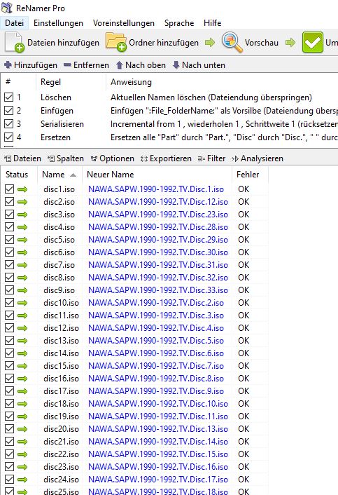

It works when I drag and drop the files manually but not when I add (many) folders with "Add folders"
When I sort by name it looks like this:
When I sort by New Name it looks like this:
