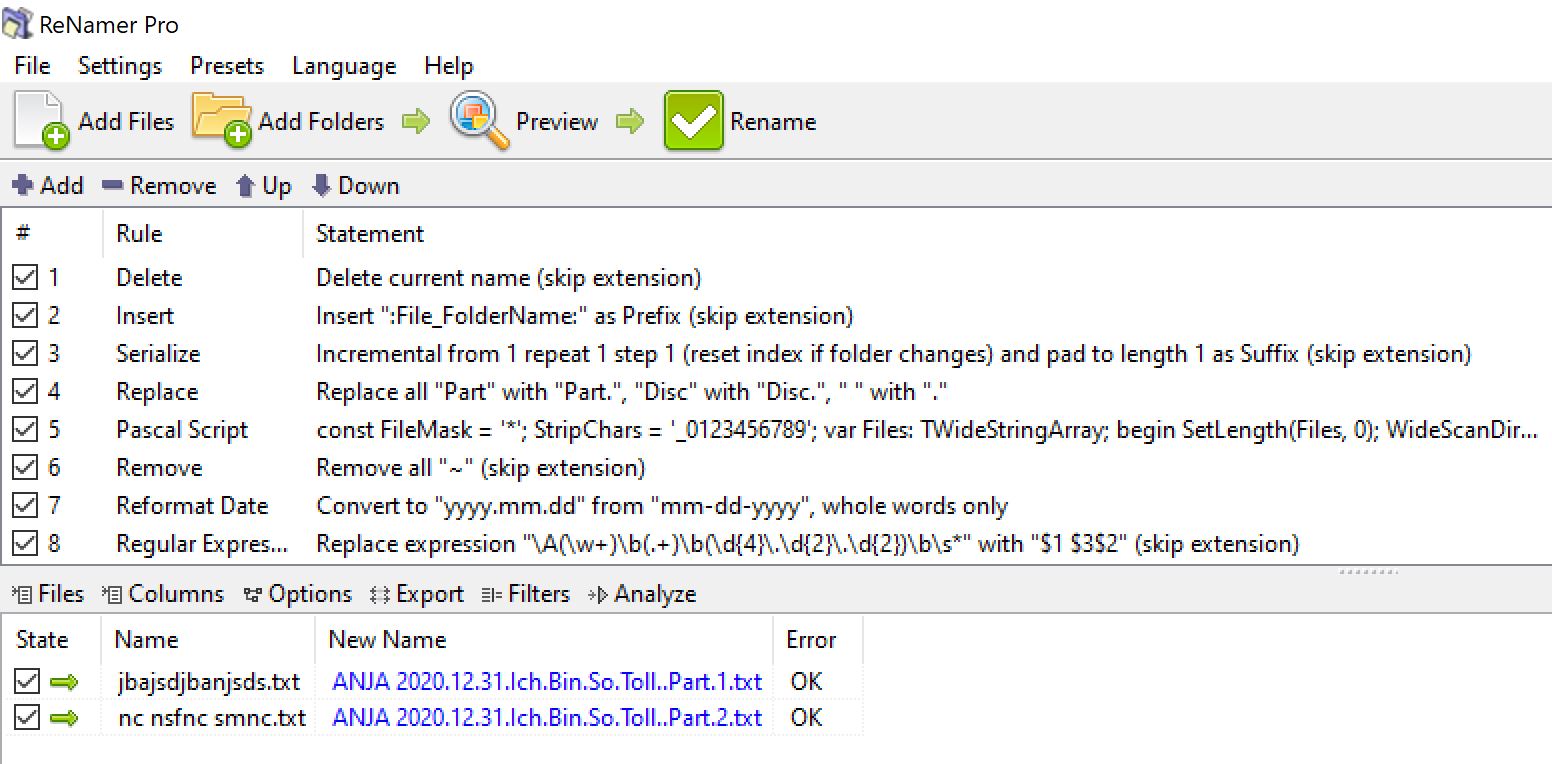

Just a minor thing I think: Why are there 2 dots ".." after "Toll"? Could you help me again, please? We're almost there! smile
Perhaps from your rule No 4 ?
Probably your folder name contains already an dot? We don't see from where that "Ich bin so toll" comes from.
To test, temporally change  <Replace " " by ".">  by  <Replace " " by "#"> or something like that.
The double dots are just a result of rearranging parts with the Regular Expressions rule. The previously posted rules were created for the original examples where spaces were used in-place of dots, but it is easy to change the rules to handle both spaces and dots.
Updated rules:
1) Reformat Date: Convert to "yyyy.mm.dd" from "mm-dd-yyyy", whole words only
2) Regular Expressions: Replace expression "\A(\w+)\b(.+)\b(\d{4}\.\d{2}\.\d{2})\b[\s\.]*" with "$1.$3$2"

Karleesi wrote:
8) Regular Expressions: Replace expression "\A(\w+)\b(.+)\b(\d{4}\.\d{2}\.\d{2})\b[\s\.]*" with "1.$3$2"
Your configuration of the Regular Expressions rule is wrong. You missed a dollar sign.
It should be as follows:
