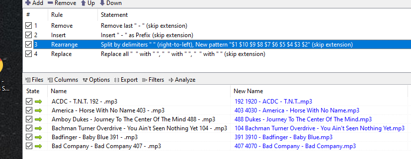

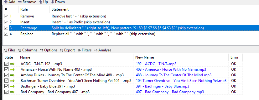

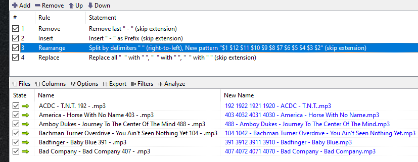

THis is as close as I get. I think my main problem is that the info before what I like to move is different long from file to file so this method is most likely the wrong way to go.
First try
Second try
Third try

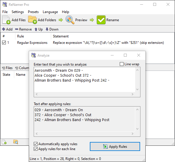

You had good attempts, but I think Regular Expressions are better suited for this particular task.
Expression: \A(.*?)\s+([\d\-\s]+)\Z
Replace: $2$1
This will move all the trailing digits, spaces and dashes to the front of the filename.
Here is a demo:
For the reference:
