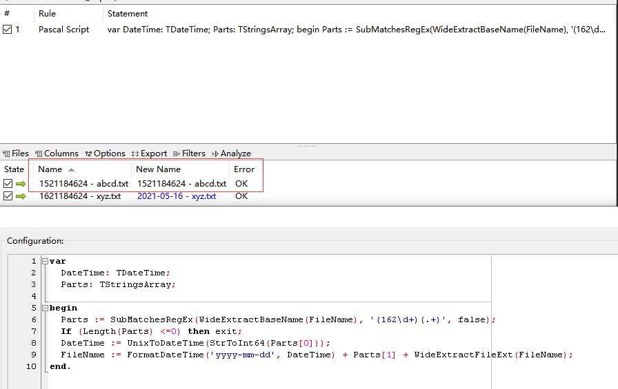

And I have a small question:
If the beginning is not 162, but other numbers, how to deal with it?
As shown in the figure, i have many files of different years.
timestamp

You're welcome. Replace '(162\d+)(.+)' part in line 6 with '(\d+)(.+)' i.e. just remove 162 and it should work smile
