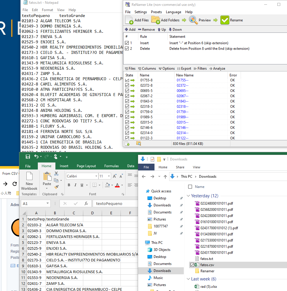

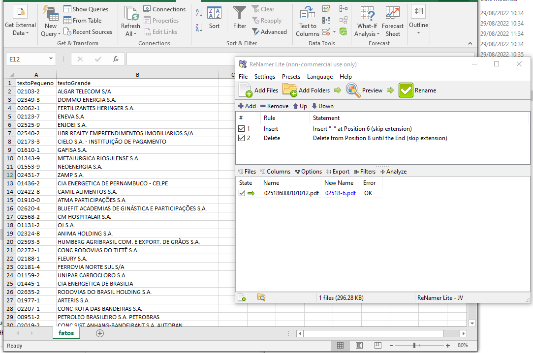

Using rules AND Import new names from a CSV file
Hi there,
I am new to the reNamer application and I can see some potential great uses for this. Wonderful tool to start with.
I had a question if I may which combines using rules and a already prepared .CSV file. I have scoured the forum to see if this has been answered but couldn't find anything.
I have PDFs that look something like this. 025186000101012.pdf. Renamer works well in helping me turn this into 02518-6.pdf
I would love to go one step further and change these into a lookup onto a CSV file. Hopefully you can see in the screenshot that it's a lookup that will translate the 02518-6 into a name.
Any suggestions on how to do this?
From 025186000101012.pdf -> 02518-6.pdf -> ABCDEFGH.pdf (just an eg)
Many thanks
JV    smile

- My CSV file looks similar to this (Split into two columns)
textoPequeno    textoGrande
01610-1            GAFISA S.A.
01343-9            METALURGICA RIOSULENSE S.A.
02422-8            CAMIL ALIMENTOS S.A.
02568-2            CM HOSPITALAR S.A.
02324-8             ANIMA HOLDING S.A.
-*Updated* - .CSV zip file if interested
fatos.zip

Using Renamer, i have 2 rules that rename the above:
1) Rule Insert - Insert "-" at Position 6
2) Delete from Position 8 until the End.
Now that we have the invoices in the right format (eg. 02324-8.pdf) - Taking v has an example.
I was hoping that perhaps renamer can use the .CSV file as a lookup sheet to match the 02324-8.pdf to whats on their so in this example it would be  ANIMA HOLDING S.A.pdf. The PDFs when we drag it into Renamer maybe in any order.
Sorry, if I m not clear, hope I have explained it a clearer.
