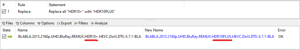

loungebob wrote:
is the plus sign (+) being treated as a special character when doing replace operations? whenever I have a file name containing a plus sign, the rename operation does not work.
eg. BLABLA.2015.2160p.UHD.BluRay.REMUX.HDR10+.HEVC.DoVi.DTS-X.7.1-BLA I need to replace HDR10+ to HDR10PLUS, then do all the other replacement operations and then revert it to HDR10+ in the finalized name.
No, the plus sign "+" is not a special character as far as the standard Replace rule goes.
Can you demonstrate your issue?
Replacing "HDR10+" with "HDR10PLUS" works just fine:
