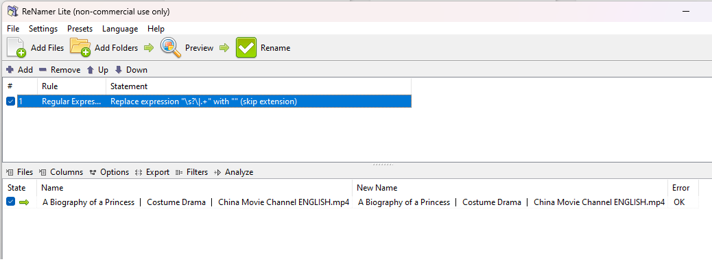

It is not working still.. did i do something wrong?
ReNamer RegEx Rule
ReNamer RegEx Rule
#4 2025-02-12 05:22
Re: Remove everything after a pipe "|" character
Maybe you are trying to replace a wrong vertical line character?
Unicode has dozens of similarly looking characters, see https://www.amp-what.com/unicode/search/vertical
You need to copy the exact character that appears in your filename and use it in the regular expression provided, instead of the standard pipe character "|".
Alternatively, you could replace all variations of the vertical line character with a standard pipe character "|" using a separate Replace rule.
Thank you so much to both of you! Indeed the unicode character is different to what i am typing. I have been trying it for sometime now. I have been reading your guides, following all the possible formatting and it never worked. I never thought it is a different type of character. I have learned a new lesson today.
