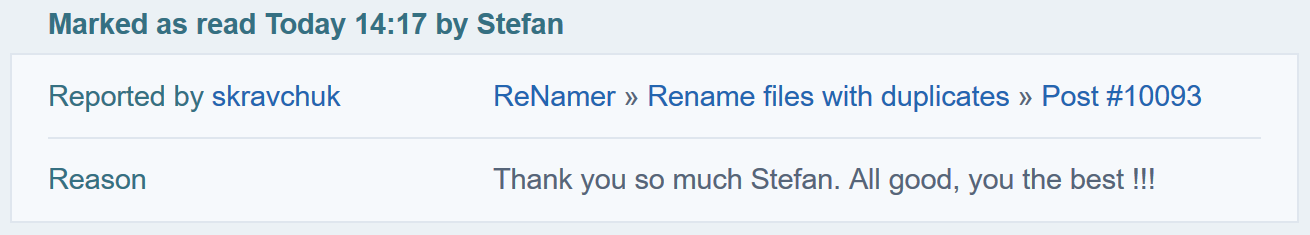

Reported Yesterday 10:43:03
Reported by skravchuk
ReNamer » Rename files with duplicates » Post #10093
Reason: Thank you so much Stefan. All good, you the best !!!
