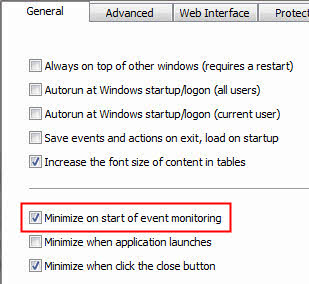

You can create links to the presets with the options menu (between file and presets menu). Place the links on your desktop or pin it to the start menu. So you can activate it easily with one click/double click.
Set the option "minimize on start of event monitoring".

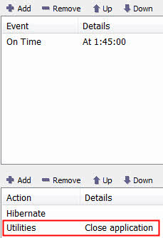

Add the action "utilities: close application" after the hibernate action. This should close the shutter process after resuming windows but I have not tested this.

Adding "utilities: close application" after the "hibernate" action works as expected. I have used it yesterday. :-)
Yes, works very well, thank you.
