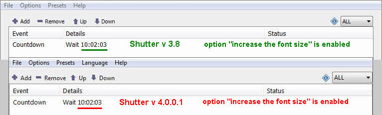

The new font in Shutter 4 is a little bit unfavorable.
This font is selected by Microsoft as the default system font. If you change your system font, it should get reflected in Shutter.
OK, but I don't want to change my system font. I don't have any problem with it (neither in Windows nor in Applications). Only in Shutter it looks so unfavorable.
