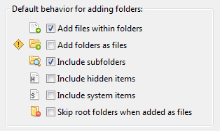

The current filtering options allow users to add both the folders and the contained files simultaneously.
While the proposed dialog makes it mandatory to select either folder or files, but not both.
Perhaps it would make sense to show all existing filtering options:
A bit of rephrasing could also help.

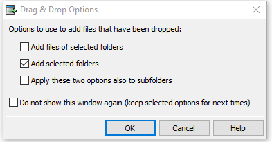

An interesting example of a similar dialog in Ant Renamer:
