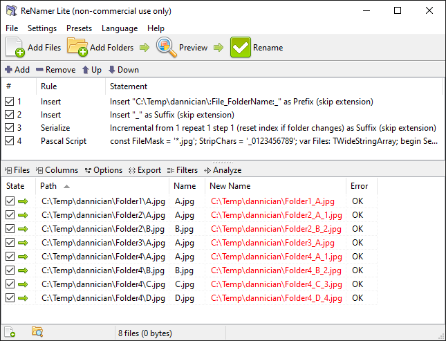

#4 2019-07-29 22:00
Re: Serialize only if more than one file in a folder
The whole thing can be achieved with a Pascal Script rule, but we'll try to keep as much as possible to the standard rules.
Serializing files according to their folder can be accomplished with the standard rules. Use the Serialize rule with the "reset index if folder changes" option. It will leave you with one last task - stripping out number suffixes from files which came from 1-file folders - that will have to be done by a Pascal Script rule.
Note that the files are sorted by the Path column.
And here is that magic script:
const
  FileMask = '*.jpg';
  StripChars = '_0123456789';
  Files: TWideStringArray;
  SetLength(Files, 0);
  WideScanDirForFiles(WideExtractFileDir(FilePath),
    Files, False, False, False, FileMask);
  if Length(Files) = 1 then
    FileName := WideExtractFilePath(FileName) +
      WideTrimCharsRight(WideExtractBaseName(FileName), StripChars) +
      WideExtractFileExt(FileName);
  end;
