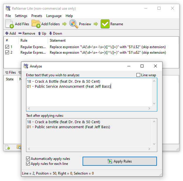

Your particular examples can be accomplished with the following renaming rules:
1) Regular Expressions: Replace expression "\A(\d+\s+-\s+)([^\(]+)" with "$1\L$2" (skip extension)
2) Regular Expressions: Replace expression "\A(\d+\s+-\s+)([^\(]+)" with "$1\u$2" (skip extension)
Here is the documentation for the Regular Expressions:
http://www.den4b.com/wiki/ReNamer:Regular_Expressions
Here is a quick demo:

You are fantastic! Happy New Year to you and to the whole forum smile
