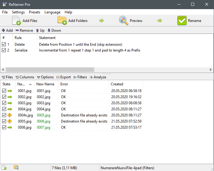

I have an ordered file list in this form:
Often I add a new file within the list:
Trying to rename the files with my simple renaming preset causes logically a conflict at "0004-new.jpg", because "0005.jpg" already exists (see screenshot at the end of this post):
1. DELETE – Delete from Position 1 until the End (skip extension)
2. SERIALIZE – Incremental from 1 repeat 1 step 1 and pad to length 4 as Prefix
Also other options in the Serialize section don't work ("Replace current name"...), because "0005.jpg" already exists.
So, to rename, I first run another preset that adds something to the file names:
Now my simple renaming preset works:
But I think it's stupid to run every time TWO presets. What can I do to rename my files in this case with just ONE preset?
Best wishes,
Fiorellino
Screenshot that demonstrates the conflict:
Conflict

Just before clicking the Rename button, sort in reverse order by the Name or the New Name column.
ReNamer always processes files sequentially from top to bottom, so sorting in reverse order will ensure that during the renaming the conflicts will not actually materialize.
Give it a try on some test files first, so you can get confident with this approach.
