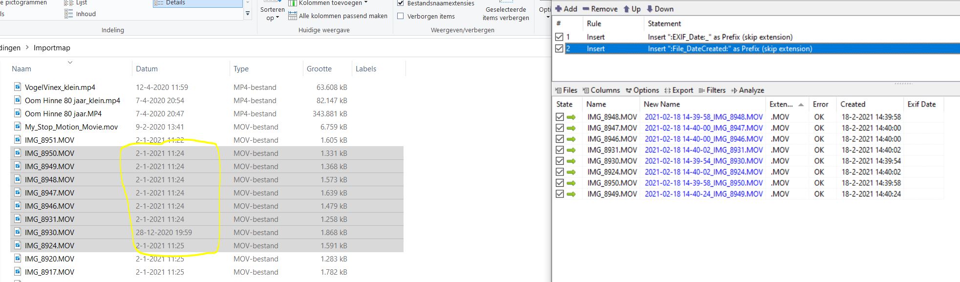

Why cannot I use create date as shown in Explorer?
Left_pane_Explorer_Right_pane_Renamer
I would like to rename my MOV files with the dates that they are created. Somehow Renamer cannot read the date where Explorer can.
I uploaded an image where Explorer shows the date I want to use, but I cannot find the rule that uses this date. I tried EXIF (works with pictures), File Create Date (only shows the date that I sent the movies to the computer).
What to do?
20210219: I get some results by using MediaInfo.exe
