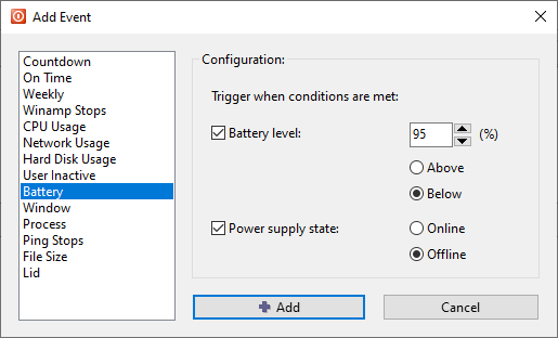

Yes, Shutter can do it.
It has a dedicated "Battery" event which you can configure to trigger when the battery level goes below 95% and (simultaneously) the power supply state is offline, i.e. battery powered.
Here is a screenshot of the event configuration:

I'm not sure. But, as long as the Windows operating system detects that the PC is running on battery, so will the Shutter.
