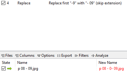

Replace rule "-9" matching "9"
Please see the attached image for the rule
4) Replace: Replace first "-9" with "- 09" (skip extension)
Renamer appears to change the original file name "p 08 - 09.jpg" to "p08 - 0-09.jpg"
yet the string "-9" does not appear in the original file name.
Showing rule

#2 2021-06-26 11:52
Re: Replace rule "-9" matching "9"
Not for me.
It is possible a problem with your first three rules.

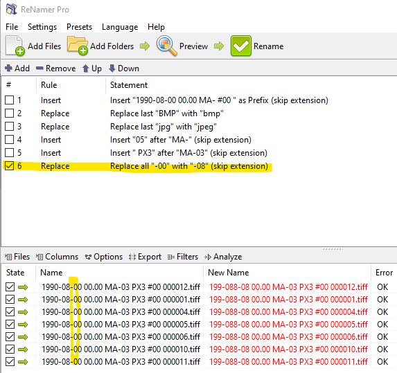

Example of rules not working correctly
Here is another example illustrating the problem

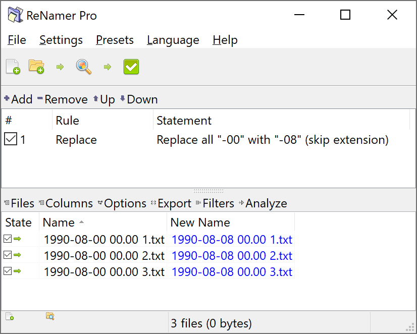

#4 2021-07-11 09:50
Can't reproduce your issue.
See a quick demo below:
Please try to reproduce your issue with an isolated instance of ReNamer, with minimal modifications. You can simply unpack a fresh copy of the portable version of ReNamer into a temporary folder.

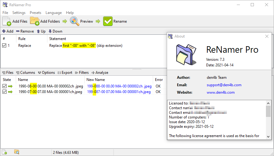

Done with the latest version of Renamer Portable.
Only 1 rule.
Showing Renamer output

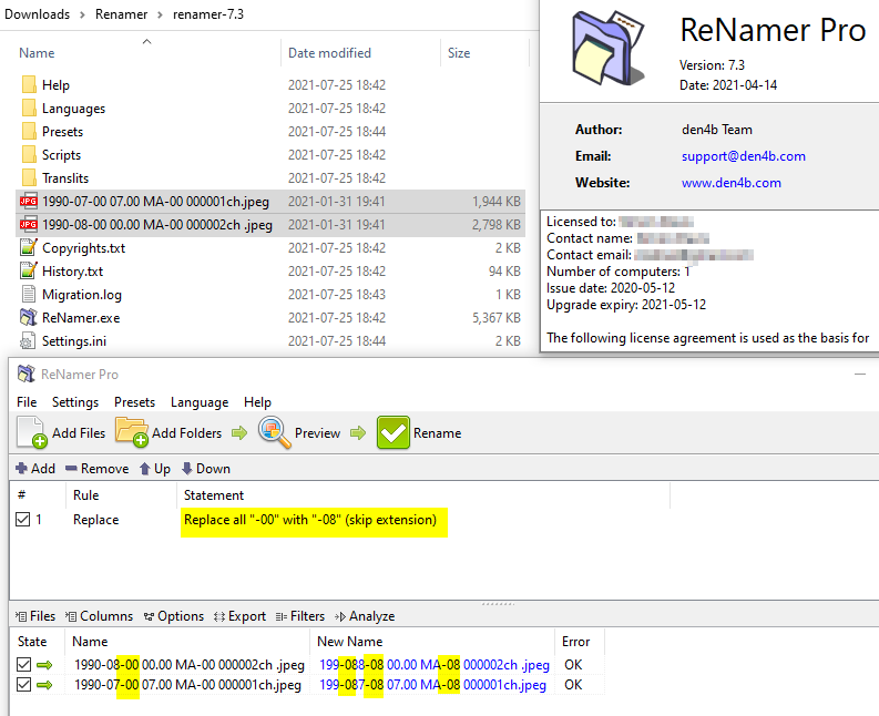

#7 2021-07-26 05:59
Still can't reproduce your issue with visually same filenames and the same rename rule.
Something odd is going on with your setup. There may be some magic Unicode characters involved.
First, try to create two empty files and name them as follows:
Copy and paste the names from the snippet above, not from your original files, it is important!
Try to reproduce the issue with these dummy files.
Additionally, please add your original files to ReNamer and export the filenames using the "Export file paths and new names" option from the Export menu. Please email the resulting file without modifying it. You can find the email address in the About dialog.

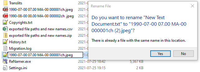

#8 2021-07-26 09:25
skiwi
Registered: 2009-06-15
Posts: 32
Export sent as requested thanks.
I created a new file and attempted to rename it, it seems there may be no hidden characters.
