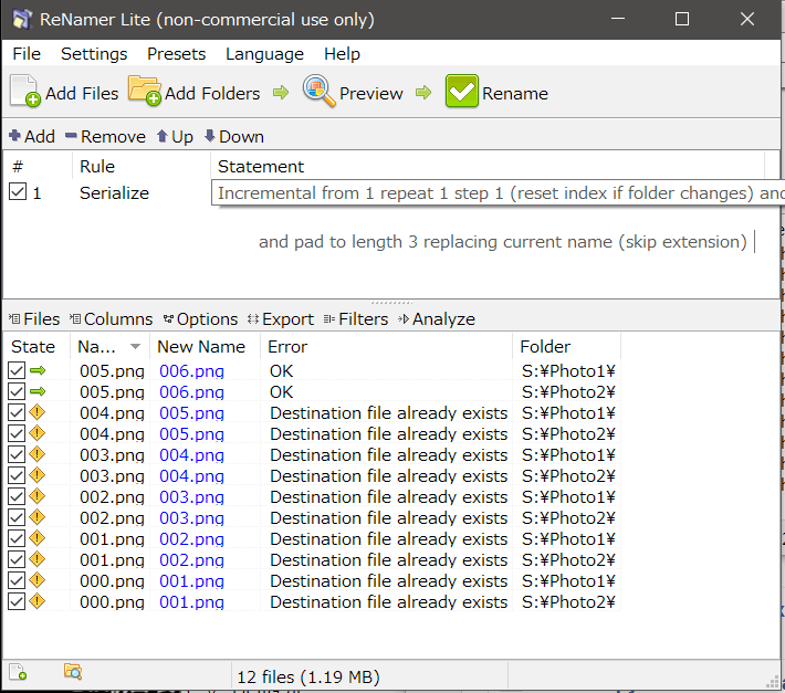

Verify after Sort the order by column
I did the following to avoid conflicts in Serialize
Sort by name column
Sort by folder column
Press F5 Preview
Sort by name column
This can theoretically OK be renamed, but Destination files already exits in Error column.
May I verify again and make Error OK?
test

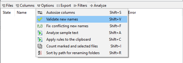

You can call the verification function on demand.
See the Options menu above the files table, or use the Shift+V shortcut.

Unfortunately I failed Validation. I got this error message.
[Window Title]
Warning
[Content]
Validation has failed due to issues with 10 file (s).
10 of which conflict with an existing file.
Hint: You can check the details by enabling the "Error" column.
[OK]

ReNamer is simply trying to warn you of potential issues due to conflicts.
For example, if the file 004.png was locked by some application, it would fail to get renamed to 005.png. This can cause a cascading failure for the rest of the files.
However, you can still proceed despite the warning, once you understand the potential issues.
