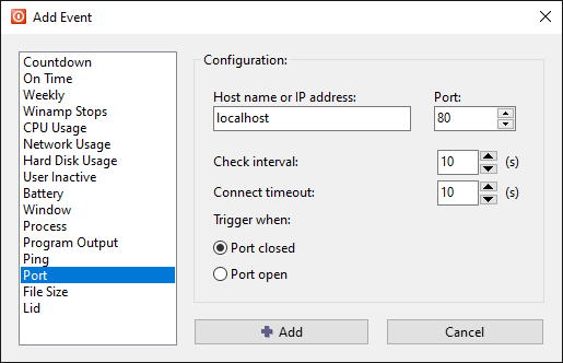

The new Port event has been implemented.
It currently has two trigger types:
1. Port closed
2. Port open
It also has options for defining the polling frequency and the connect timeout.

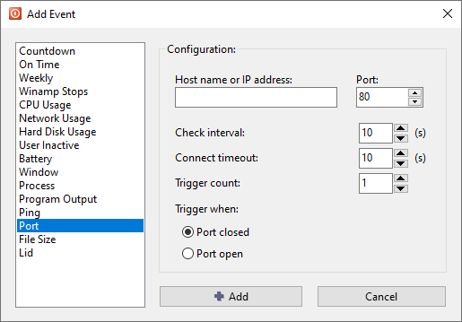

The question is whether this even should have additional trigger types similar to those found in the Ping event, which would trigger when the state persists for a certain period of time, rather than instantaneously.

On the question of "which would trigger when the state persists for a certain period of time, rather than instantaneously" - yes, I think this would offer even more flexibility and prevent potential looping of the event trigger.

This feature is available in Shutter 4.5.
Here is an updated screenshot:
