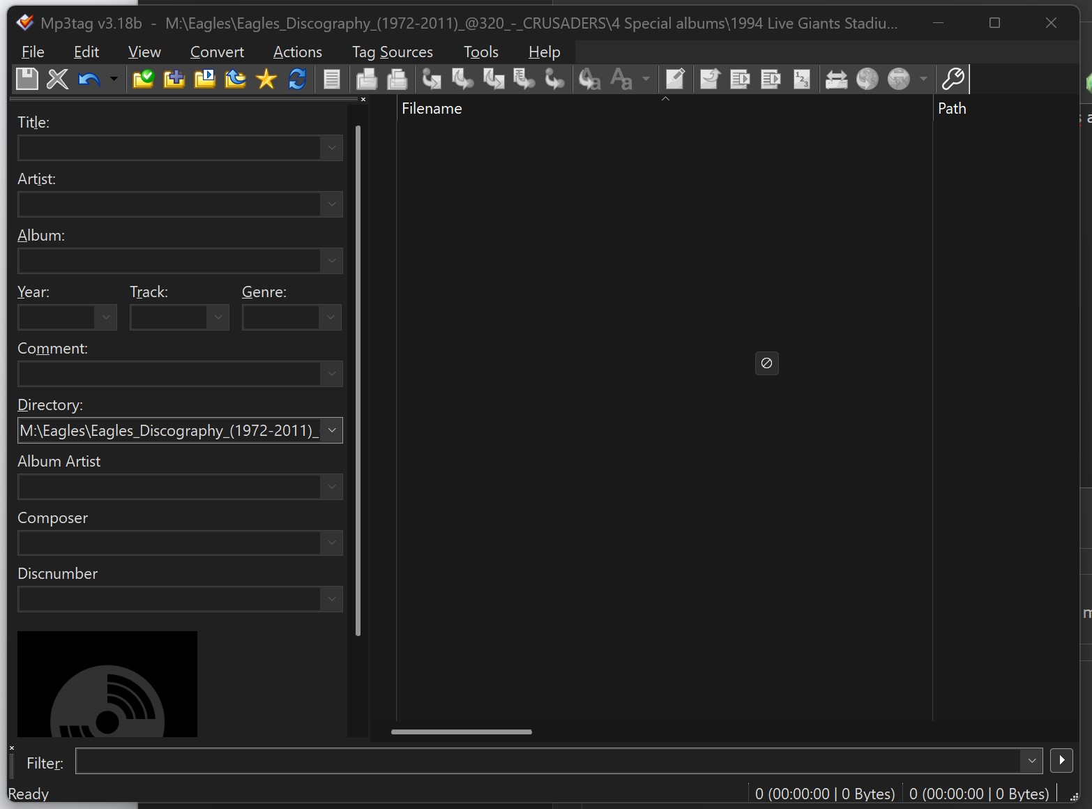

Update to my update - I tried running MP3tag with admin privs and drag and drop doesn't work then, either.
BUT...
What it does do is put up the little circle with a slash symbol to say it can't do the requested drop, while ReNamer just doesn't do anything.  I think that the way they do it is much better, so you understand that it is not broken, but unable to complete the task/
