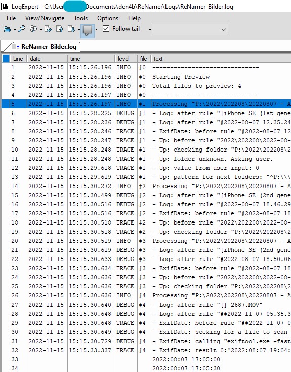

Got some logging
Just managed to get a log flow over all rules and/or files without disturbing by the use of dialog popups.
Log viewed with LogExpert
Prerequisites
I implemented the two functions proposed by Denis in their Wide variant:
procedure WideSetScriptVar(const Name, Value: WideString);
function WideGetScriptVar(const Name: String): WideString;
With this I could store LogFilename, LogLevel and also the last version of FileName and use them in any rule.
The implementation is not the smartest as it stores the values to the filesystem. But as a proof of concept they do what they should do!
Global value storage and logging have been implemeted in a file which has to be included in your Pascal Script rule.
Usage
As first rule I add a Pascal Script to initialize the logging:
{$INCLUDE Logging.pas}
const
  LOG_FILE = 'C:\Users\xxx\Documents\den4b\ReNamer\Logs\ReNamer-Bilder.log';
  Initialized: Boolean;
procedure Init();
  if not Initialized then
    (* Initialization *)
    LogInit(LOG_FILE, TRACE, [LOG_CLEAR,LOG_HEADER]);
    Initialized := True
  end;
end;
  Init;
  Log(INFO, 'Processing "'+FilePath+'"')
Here I set the loglevel to TRACE and also say that for every run the logfile shall be cleared. The last line puts the full filename of each processed file to the log.
For watching the progress of a single name through the rules I now can insert additional Pascal Script rules with just:
  LogFileProgress(DEBUG);
More complex implementations in Pascal Script can use their own log statements after including this lib.
Viewing
By now I just use a static filename. With an additional tool like LogExpert I could see the log entries at the time they are written (like the unix tail).

BTW: I'm curious if there isn't someone out there interested in outputs like the one suggested in my screenshot?
