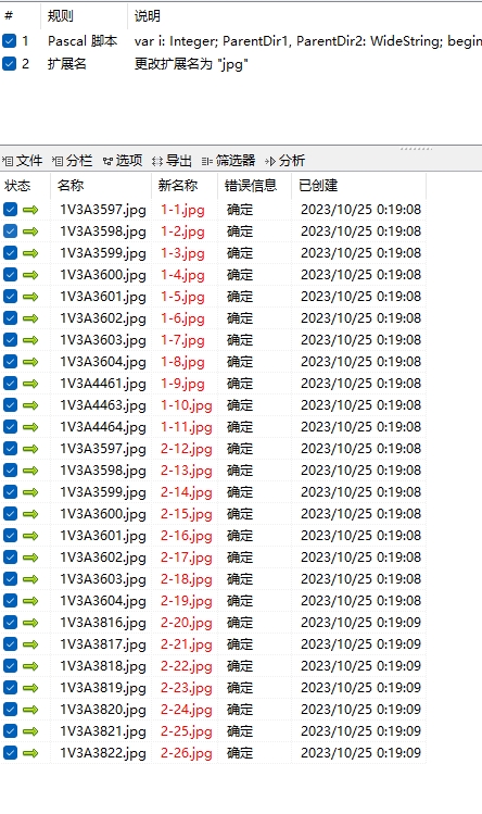

Serialize files by parent folder name
Hello, this is my current code.
  i: Integer; ParentDir1, ParentDir2: WideString;
  ParentDir1 := WideExtractFileDir(FilePath);
  ParentDir2 := WideExtractFileName(ParentDir1);
  i := i + 1;
  FileName := ParentDir2 + '-' + IntToStr(i);
What I want to do is to completely modify the file name, and the rule is to add the parent folder name and sequence number.
This code can successfully name a single folder after dragging it in. But when I drag multiple folders, the sequence number will continue from the previous folder to the next, and the second folder does not start from 1. What should I do?
For example, the result I want is 1-1,1-2,1-3,2-1,2-2,2-3
But the result after running the above code is, 1-1, 1-2, 1-3, 2-4, 2-5, 2, 6
Also, after using this code, the extension disappeared. How can I keep it?

Yes,
Before:
I want after:
The actual files are much more than here.
But now, that's all I can do.

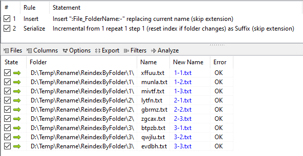

#4 2023-10-25 08:54
Posts: 3,543
Re: Serialize files by parent folder name
You can do this without the Pascal Script rule, with just these rules:
1) Insert: Insert ":File_FolderName:-" replacing current name (skip extension)
2) Serialize: Incremental from 1 repeat 1 step 1 (reset index if folder changes) as Suffix (skip extension)

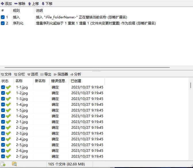

#5 2023-10-27 03:27
SleepGlasses
Registered: 2023-10-24
Posts: 3
https://www.den4b.com/forum/img/members … folder.png
Thank you very much for your guidance, now I can use it smoothly! ! !:lol::lol::lol:
