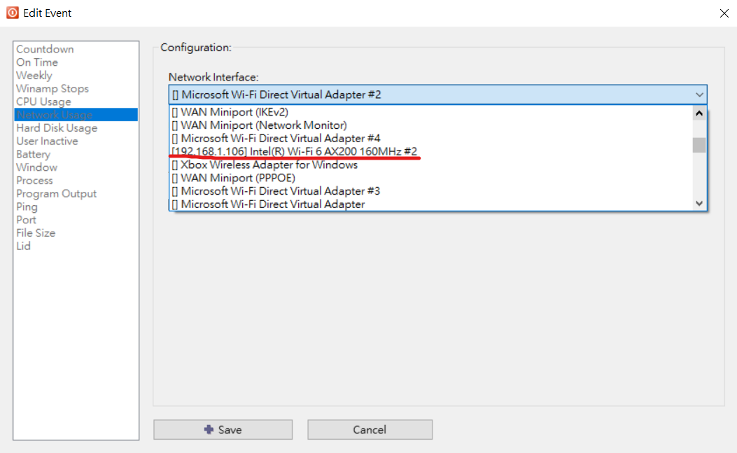

I've tried to monitor the internet traffic to decide when to shutdown, but no appropriate interface could be set.
The one with red color underline is the right one and could be saved.However, no stream could be detected in status and when i back to the
configuration it is already overrided by another interface. All the versions including portable and beta had been tested and the same issue still came out.
This issue is also found in another similar app, but I also found one could work normally with this interface means it's the correct choice.
Is there any solution? My OS is win10.

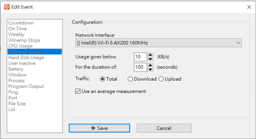

That's weird.
My Mac address is not dynamic and is saved correctly in the prest file.
but the status is still 0 KB/s all the time even opened with admin.
It seems that shutter knows the exact mac but is failed to acquired it.
The following picture shows the overidded option after I saved the correct one with ip in the beginning.
Is it relevant that i'm using Wifi for internet?

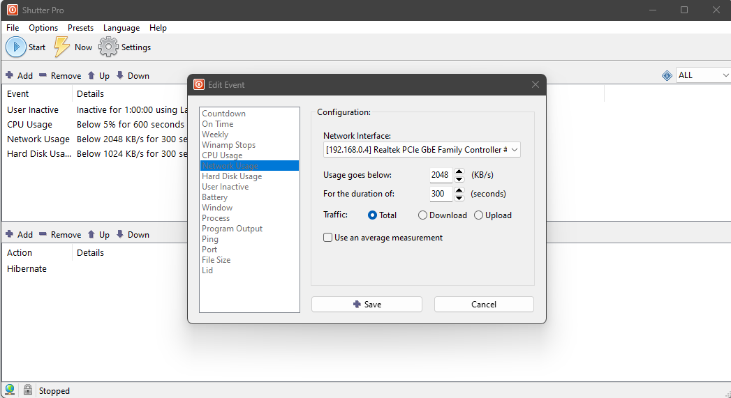

I have a similar problem.
My selected network card is not saved correctly.
MAC address is static and yet it always jumps back to a default adapter after saving.
What I specify:
What ShutterPro saves:
But everything looks correct in a saved preset.
No traffic is displayed either.
So it doesn't seem to be just a display problem
Every other adapter is saved correctly.
Any suggestions for solutions?
