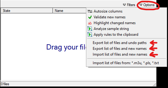

Thanks for the reply.  This software is installed by my firm at the corporate office level so I have no control over its upgrading.  Also, I looked and do not even see an Options menu (just File, Settings, Presets, and Help).  I've looked around every option in the menu but do not see an export option.  Perhaps it was locked down at the administrative level.
#12 2024-04-06 01:46
Re: Search for given filenames and Replace them with new given filenames
Find the "Options" menu located above the top right corner of the file table.
This is what it should look like in ReNamer 4.65 or thereabouts:
