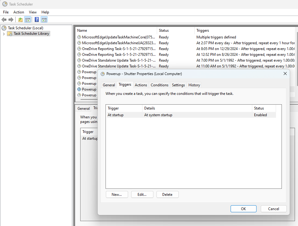

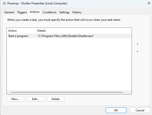

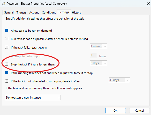

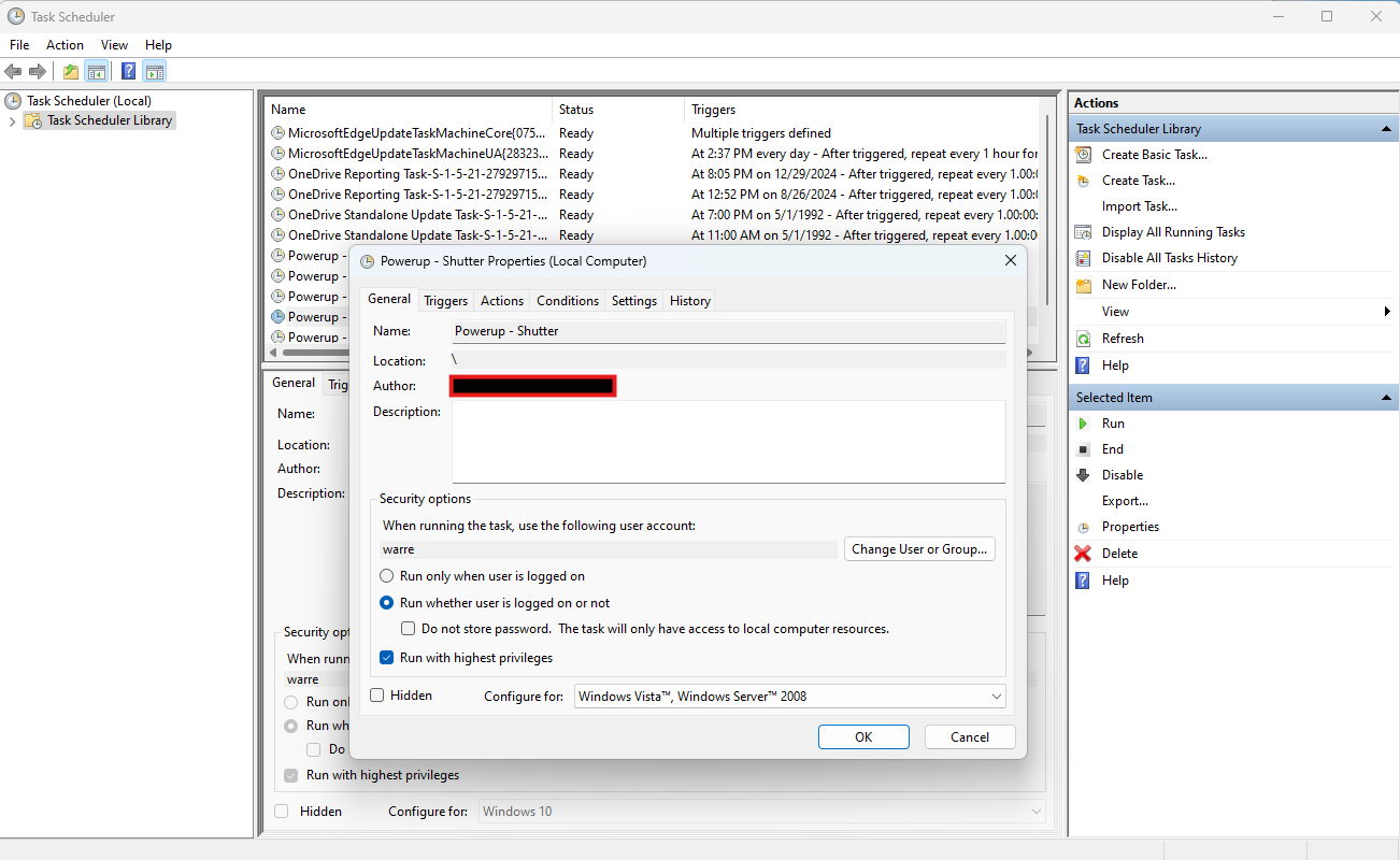

To do the "start Shutter on this host without logging in":
I created a "Basic Task" in Task Scheduler called "Powerup - Shutter" that would run as me, "Whether user is logged in or not", with "highest privileges" just in case (my user account has admin privileges - this required me to enter my password on setting up the Task, but not every time it fires):
With a Trigger of "At system startup",
With an Action to launch Shutter.exe,
And disabling the default setting to kill it after 3 days:
And I can confirm, if I reboot my PC (as with Shutter, remotely, without being at the computer to logon), after giving it 30 seconds or so to complete the boot-up, I can use the Web Interface again through the configured port from the Internet to see the menu (with a login/password).
