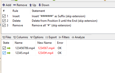

Thanks for the quick reply, this almost work, see attached

#5 2016-07-01 11:24
Re: Rename All Files to 8 Characters Long
Ah, yes, you wanted all to be 8 chars long, and I thought one step to many.
(But why did "Use Remove: "#" All" let one sign left?)

#7 2016-07-02 00:49
This is a regression introduced in v6.3.0.3 Beta.
It affected replacement of consecutive "Find" parts, where current position was incorrectly incremented by an extra 1 char, causing every 2nd consecutive "Find" part to be skipped.
This will be fixed in v6.5.0.3 Beta.
