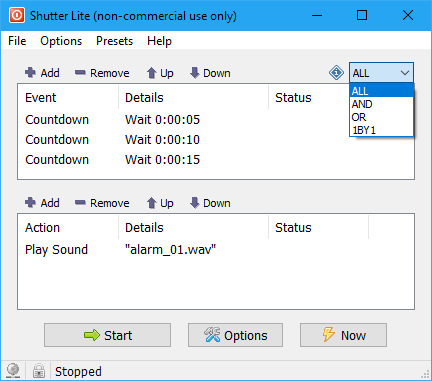

Is it possible to do multiple countdown alarms with a sound after each countdown is completed?
It plays a sound after one countdown timer. It plays one sound after all countdowns are complete. I couldn’t get it to play a sound after each countdown was completed.

If you want to play an alarm periodically with the same interval, then you could get it to restart events after the alarm has been triggered.
For example, using event:
1) Countdown: Wait 0:00:05
With actions:
1) Alarm
2) Utilities: Restart events
If the intervals for alarms are not same, then you will need multiple instances of Shutter each running with it's own timer configuration.
