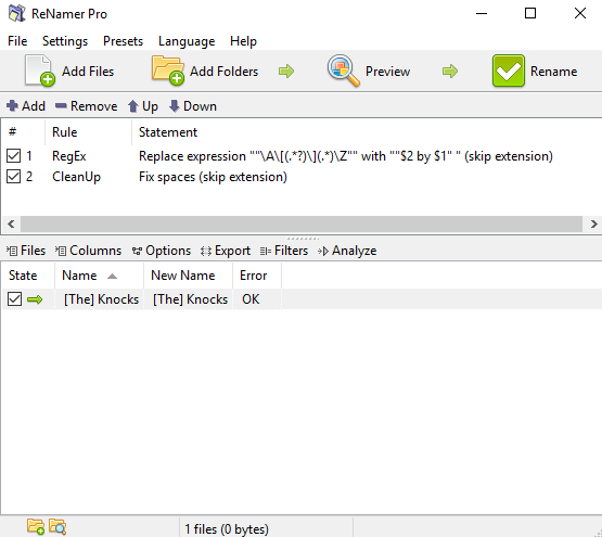

Thanks for the reply but it still doesn't do anything for me.
Doesn't Work
You need to remove the double quotes from the expression and replacement pattern.
#5 2016-09-24 00:29
rickyricky
Registered: 2016-09-23
Posts: 7
Re: Switch Folder Value Names Using ReNamer
Okay now it works thanks.
