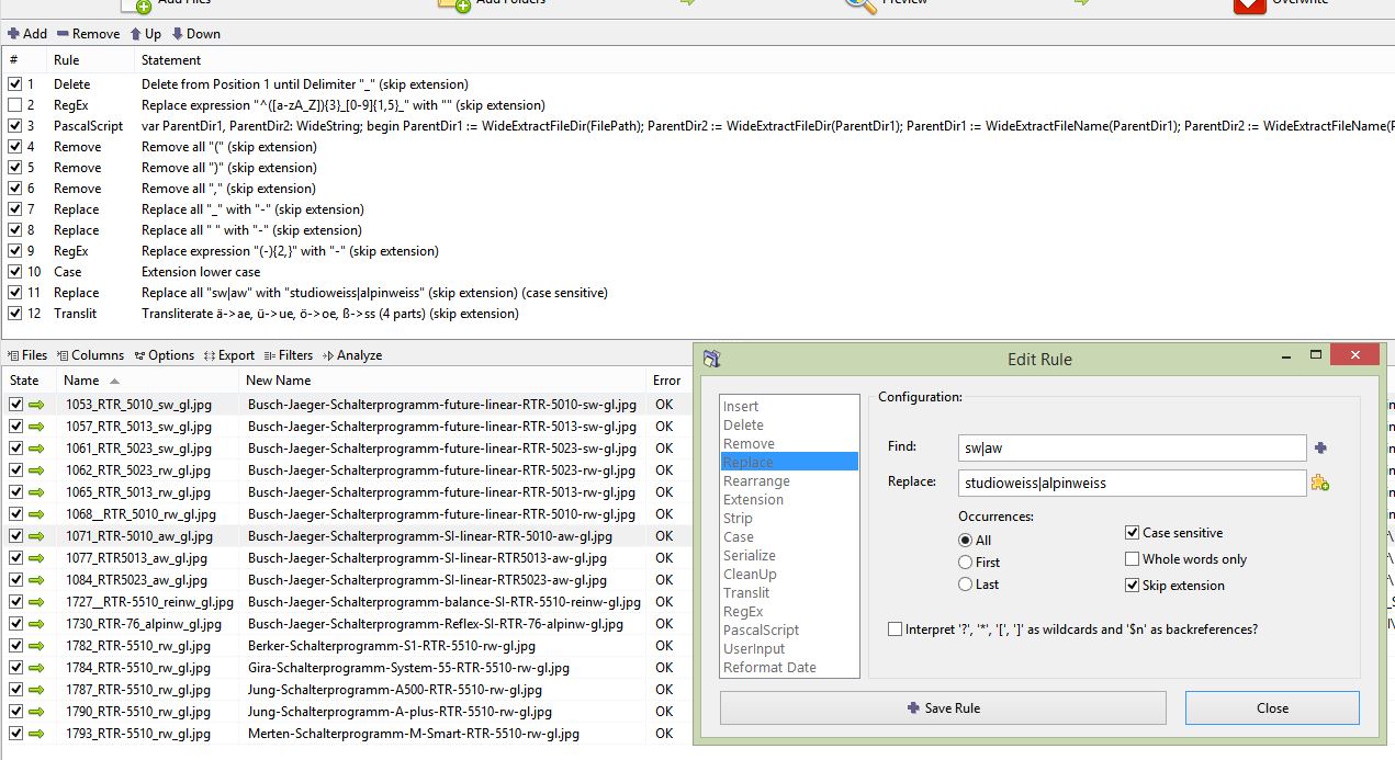

replace multiple items not working
Hi there,
i´m wondering why rule #11 ist not working like expected?
(see image)
I´m using ver. 6.5
thanks
#2 2016-10-17 10:09
Posts: 3,533
Re: replace multiple items not working
Hi,
You have used a wrong delimiter to separate multiple find/replace patterns. It should be "*|*" instead of "|".
So your find pattern should be "sw*|*aw" instead of "sw|aw", and same applies to the replace pattern.
Note, different rules may use different multi-item delimiters.
Thanks a lot, it works perfectly now.
I thought the asterik would stand for wildmark example.
#4 2016-10-17 11:24
Posts: 3,533
It would if the wildcard option was enabled.
In that case, you won't be able to use a multi-item delimiter and will need to use multiple rules instead.
