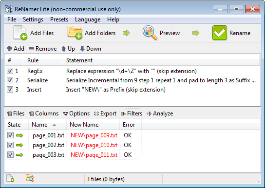

There are several different ways of achieving this with ReNamer, but with the information that you have provided the following should work best.
Use these 3 rules:
1) RegEx: Replace expression "\d+\Z" with "" (skip extension)
2) Serialize: Serialize Incremental from 9 step 1 repeat 1 and pad to length 3 as Suffix (skip extension)
3) Insert: Insert "NEW\" as Prefix (skip extension)
This removes existing trailing numbers and renumbers them using the Serialize rule. The 3rd rule is optional, it just ensures that new names won't clash with any existing names. You can safely move them back later. Also, make sure that files are sorted by their name (click the "Name" column), so that they are renumbered correctly.
