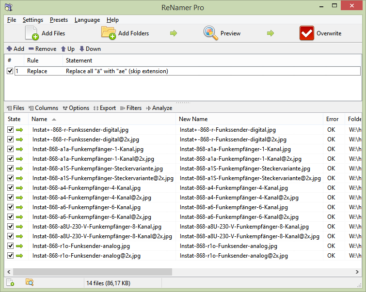

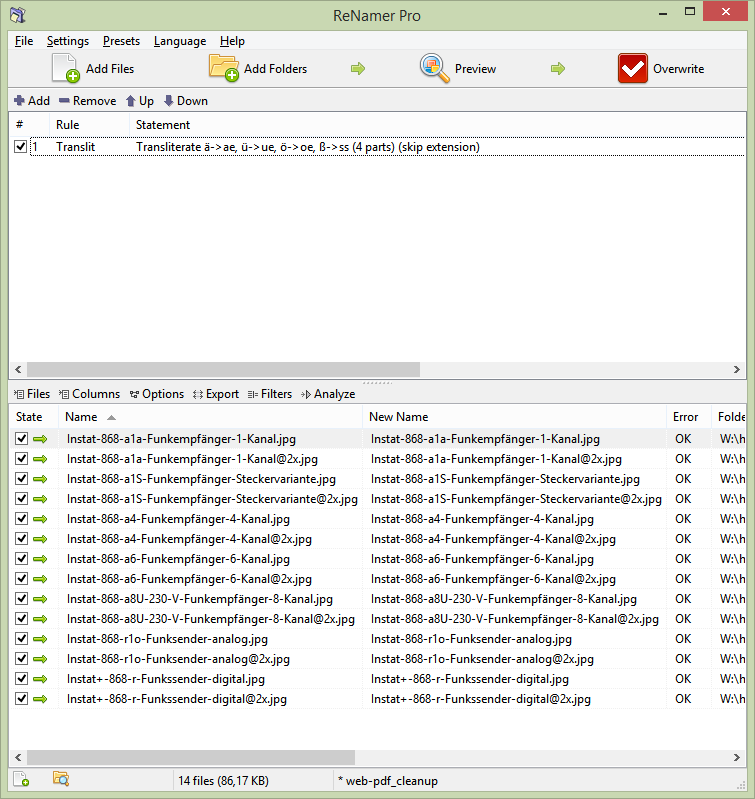

Translit not working anymore with "ä"?
Hi there,
my transliterate rule is not working - wonder why, ´cause i never had problems before.
thx
PS. using last version 6.6

can´t even use replace function.

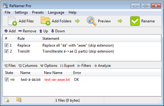

Hi,
Your filenames most likely contain a combined Unicode character instead of a single character "ä", i.e. two separate characters "a" and "¨" which are rendered on display as "ä".
To capture that combined character you can select it (copy & paste) from the actual filename and into Replace or Translit rule. It won't look any different to the one "ä" you typed manually, but it will actually be a different binary representation. Sneaky Unicode.
Both Translit and Replace rule work as expected.
