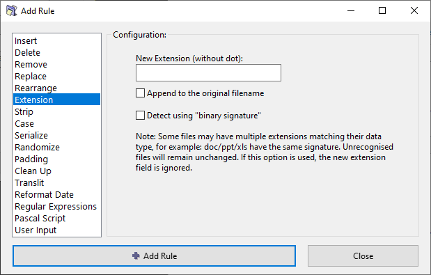

This rule allows you to attach a new extension. It is useful when the extension of a file is missing (or if the file has a wrong extension). There is an option to find the correct extension based on the file's structure.
The parameters are as follows:
Parameter Details
New extension New extension that has to be added to the filename.
Append to the original filename If this option is selected, the new extension will be placed after the old extension.
If it is deselected (default option) the new extension will replace the old one.
Detect using binary signature Try to detect a correct file extension using built-in Binary signatures of commonly used files.
