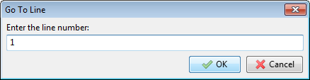

  • In case some error comes up, the error message will identify the line number of the faulty statement.
    You can try and troubleshoot the problematic statement in the script using the GotoButton.png button.
    ReNamer opens a window like this:
    Now enter the line number in the window and press OK. It takes you to the faulty statement.
    Try to edit the statement and compile the script again.
    (Note that if the script compiles successfully, the GotoButton.png button is not required at all.)

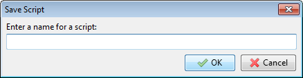

5 Saving the script and giving it a name:
The save button is hidden under the scripts menu. So first click on the ScriptsButton.png button. It pops up a window like this:
Note that all the existing scripts are listed here. (When you save the new script, it will also be added to this list.)
Select the Save script... option (at the very bottom of the menu). Another window pops up.
Enter a name that suggests the function of your script. Press OK. The new name is added to the list of scripts. Now use it as described above.
