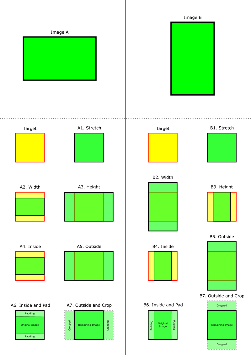

A demonstration below attempts to visually describe the operation (logic) of each fitting methods.
  • Image A has aspect ratio greater than that of the target dimensions box.
  • Image B has aspect ratio lesser than that of the target dimensions box.
  • Target dimensions box is represented by a square for simplicity, while height and width can actually differ in practice.
